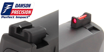

I'm wondering if anyone has tried this Dawson front and rear sight on their P365, and if so is it really a plug and play type of arrangement or does some fitting need to be done.

I was using the Dawsons for awhile, and they give a decent sight picture in okay light. I did have trouble keeping the sight tubes in; may have been the abrupt slide movement, or it may have been how I was heating the tubes.

As above, the stock XRAY3's are a bit dim. You can try and contact Sig and send some pictures for evaluation, but green is, well, green. Sometimes I think most folks would be better off with regular white three dot steel sights.
I'd look at Dawson, Ameriglo or Trijicon. Haven't had a set of Trijicons for a while. The last set I had was on an M&P, but the rear sight was so stabby it ate through clothes. I don't know if they've addressed that. The Dawson FOs are a good option. I've owned several and they are very good outdoors, but on an indoor square range they are as black as a set of black steel sights. I put a Dawson FO on my 1911 because it is a range gun for outdoor matches (bowling pins) in the summer.
For general use, and it it is an option for the pistol, I vastly prefer Ameriglos. I'm partial to the model with the tritium lamp and bright orange ring. I had any number of these on my Glocks and really picked them up well.
All dovetail sights are probably going to require fitting and either a good hand/bit of experience to install or a decent sight pusher.
