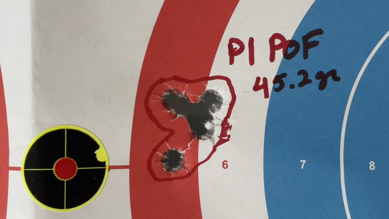

Here's two five shot groupings, the top is with a POF Revolution DI (.308 gas gun) and the bottom is a bolt action Sig Cross. I was developing a 110 grain load, just trying to see what sort of velocities/accuracy I could get out of this particular bullet as I have a bunch lying around and 3,000fps+ intrigues me. I completely pulled on shot with the AR so groupings are about the same for both albeit at different velocities and powder charges at 100 yards. If I'd thrown a red dot on the POF, my groups would have been larger without a doubt.
