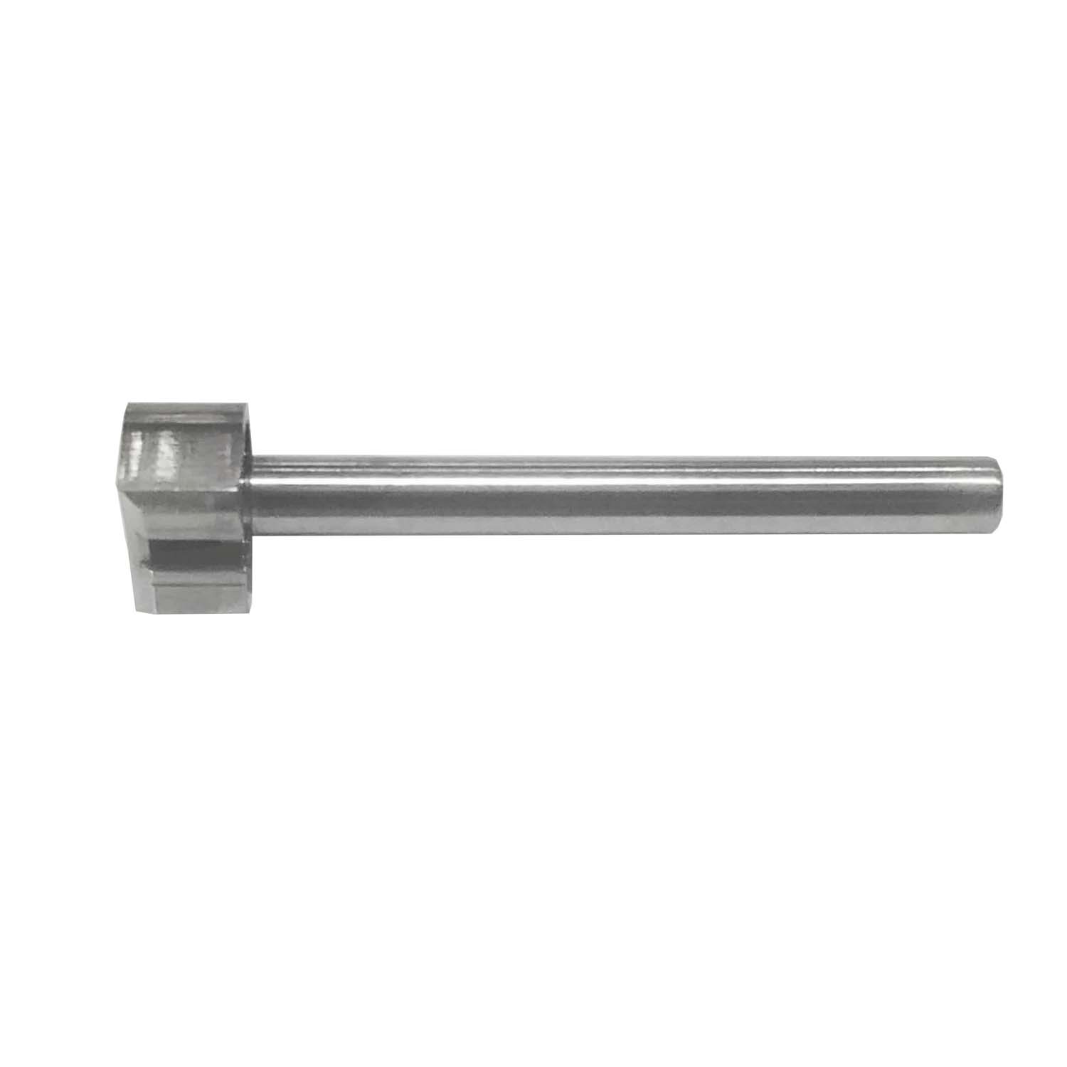

Is this one piece?
Recoil Spring Guide - P938
I have just posted they seem to be out of business.
No, that's the Sig OEM two-part piece. They still manufacture 2-part-piece.

This is the first time I hear that Sig has offered a one-piece rod for P938 - are you quite sure yours is a one-piece rod?
I purchased a P938 that was manufactured in Sept 2021 and it came with a one piece rod, so maybe call CS.
To the best of my knowledge, Sig has never supplied a one-piece guide rod. You might want to look more closely, and I think you’ll find a seam. If yours is working fine, that’s wonderful. You might check every now and then to make sure the two pieces are not separating.
Just field striped the 938 and I guess you are correct. I never noticed the seam that is right up at the large end. Mine has never given me any problems.
