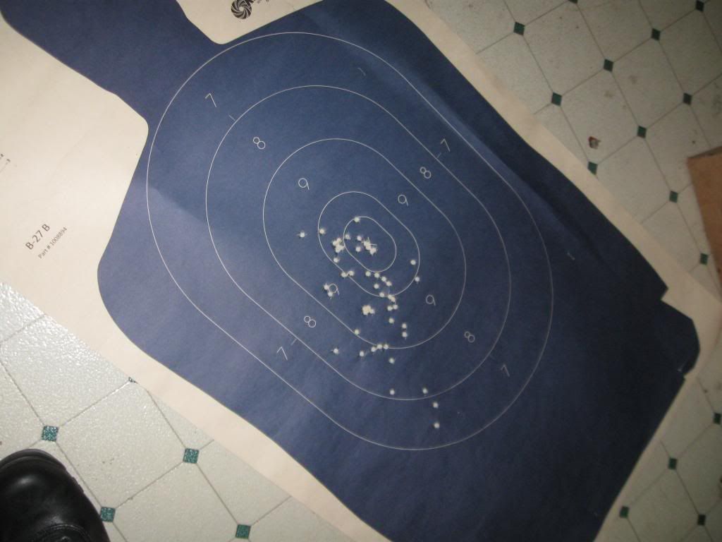

This is a problem I'm having primarily with my P239, not with the P226 which I've fired only 6 magazines through and found to be very accurate, nor with my P229 which even my 1911-loving friend has called "deadly accurate!" when we were out shooting together- so it's got to be something to do with the way I'm handling the P239, is my thought.
Today I shot for the very first time on a proper silhouette target, 51 rounds of 147 grain Hornady XTP. While I consistently hit in the 9 and 10 rings with just a few in the 8 and 2 hits in the 7ring, the VAST majority of my shots went low and left of the mark.
According to the correcting chart I have seen, this means I am gripping too tight; yet I swear that my aim remained on the X every time I squeezed the trigger and the pistol was not jerking. How can I correct this tendency? (For all those who are about to suggest "Hogue rubber grips"- been there, done that. I just don't like the way they feel. I currently have checkered G10s installed, which did improve my felt recoil over the factory grips and also helped me improve my accuracy- it's just that I still feel I can do better.)
I am dealing with similar issues with my SP2022. It's definitely over gripping (for me), and I have been slowly solving my problems by relaxing my right hand grip on shot, and making a conscious effort to pull my thumbs off of the left side of the pistol. Once I am shooting "thumbs off," my shots are much more consistent and on target.
Simple, but not easy (for me). It has been working, though.

Have you had anyone else shoot the gun? It would be interesting to at least rule out incorrect sight alignment.
Could it be your grip is changing to adjust to a shorter grip length? That may be happening without you changing the grip strength, but could affect your aim. Also, is your off hand in the same position as it would be with your 226?
Well, that explains a great deal. I apparently never knew what "over gripping" WAS. I assumed it was a matter of squeezing too tight with my fingers, so I tried to relax them and let my right thumb do MORE of the work. I just tried dry firing both ways at a mark on my wall very close to me, and I can see the way the front sight drifts to the left when my thumb grips the gun, but stays on target when it doesn't. Now I am more eager than ever to get back out and shoot again. Today's trip corrected my "pushing" problem- next time will work on my grip- then it's off on vacation. Thanks!

Well, now, bearone, I just looked at the chart again, and that's what I thought I was doing- but as a consequence of trying to relax my fingers, I was tightening my thumb. Which led to the problem 9mil mentioned and which I am going to try to correct. How exactly do I maintain a good grip without overtightening? is my question. I will accept any advice!

I was tipped off to my issues from the book, "[ame="http://www.amazon.com/dp/1610045718"]The Perfect Pistol Shot[/ame]," where the author was emphatic that a tight grip was not only not necessary but detrimental to accurate shooting. After reading SO much here about tight, firm grips to avoid limp wristing, I was making sure that with every shot I was focused on holding the grip tightly. Obviously, I was over-gripping as described in that book.
I feared issues with FTE or FTF with a softer right-handed grip, but it was not the case at all. By using the left hand as firm support, then using the right hand to aim and pull the trigger (and intentionally keeping both thumbs off of the gun), I was able to get all of my shots inside a 3" circle from 25' with very few bottom-left fliers. Previously, I would shoot every successive shot in a single mag (after an initial bullseye shot) lower-left than the previous shot.
I'm still not where I want to be, but at least I know it's ALL my technique and that I can improve it by focusing on a few simple things for each shot.
I'm no experienced marksman, and not saying that what worked for me will work for anyone else, but that book helped me a lot. It most certainly erased a lot of frustration I was feeling with the SP2022.

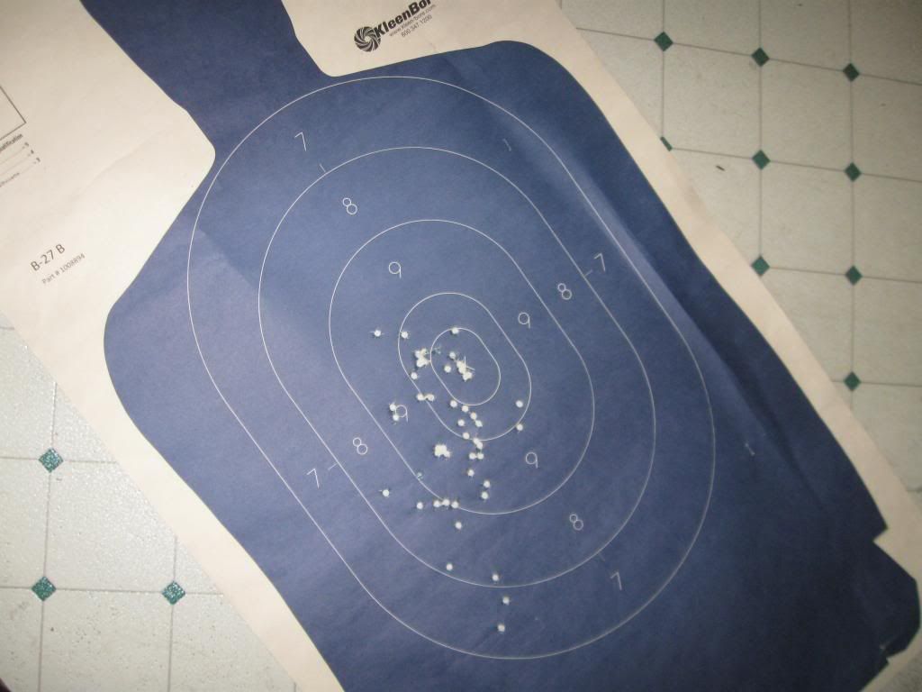

After not making it out to shoot all last month, I finally got out yesterday. I had the factory grips back on the P239, because I found the checkered G10s to be just a little too aggressive and rough on my hand as well as snagging on my clothes when I carry, so I thought that might affect my accuracy- not a bit. I followed the advice I got on this thread and others, made a conscious effort to keep my thumbs off and my pinky away, and put the first 2 mags almost dead center from 25 feet. It was only when I tried a little rapid fire with the third mag that I started drifting again, but even then (as you can see) it was nothing like as bad as I once was. Even in rapid fire, only 2 fliers went as far as the 9 ring (1 of those holes was from my first mag)- and given how I was doing before I kind of hesitate to call them "fliers"!
(These were 357 SIG, Hornady 147 grain XTP rounds, the same as I've shot all along.)
Then it was time to put up a new target, back up 2 more paces, and get out the P226, which I had only shot once before, on a memorable day this spring (see my "Day At The Range" thread http://sigtalk.com/sig-sauer-pistols/11271-day-range-photo-heavy.html if you want to see how that went (awesome)).
From 30 feet and with 7 pre-loaded mags, it was time to go to work. I had a grab bag of ammo; 1 12-round mag of 180-grain Federal FMJ (the last of the box), 3 mags of American Eagle 155gr FMJ, and 3 new 13-round Mec-Gars filled with Federal 155gr Hi-Shok JHP (if you've never heard of it, that's their low-budget alternative to HydraShok). I was particularly eager to shoot these, as this is my #2 carry loadout when & if I can't get Speer 155 Gold Dot- but I started off with FMJs, saving the best for last.
3 main impressions that I took away;
1) 180gr Federals kick like a freaking mule.
2) American Eagle is the smokiest, dirtiest ammunition I have ever fired. I **** you not, I had soot marks up to my elbow. I expected to see wadding coming out of the barrel.
3) If you can keep your off-hand index finger on the 'hook' on the trigger guard of a .40cal P226 during recoil, you are more of a man than me. I just got used to putting my finger back in place after each shot, rather than trying to keep it there and seeing if the skin would actually get torn off. :eek:
But the important thing is, I was able to apply the lessons I learned from my P239 to its larger cousin. Thumbs off, don't milk the grip. Out of 87 rounds fired, I spot 1 in the 7 ring, 2 in the 8, about 20 in the 9 with 2 or 3 on the line. And 2 nice, ragged holes in the 'X', plus a freaking HUGE jagged hole in the 10 ring. Admittedly, they are still a little bit to the left; but once again, not too much, and not nearly as much as when I started out on the "accuracy quest".
These were aimed shots, about 1 1/2 seconds between each, from the Weaver stance. At closer range- the range where I'm most likely to be forced to use my weapons- it could only get more impressive. I'm never going to be one to put 10 rounds in one ragged hole at 20 yards, but I am satisfied with my accuracy. At this point, I believe my grip is good and it's more a matter of sight alignment, which is a project for another week; some day I'll get myself a rest to lean on so I can really concentrate on the sights alone.
That target won't hurt anybody ever again. Thanks to all for your advice and encouragement, and stay safe!
