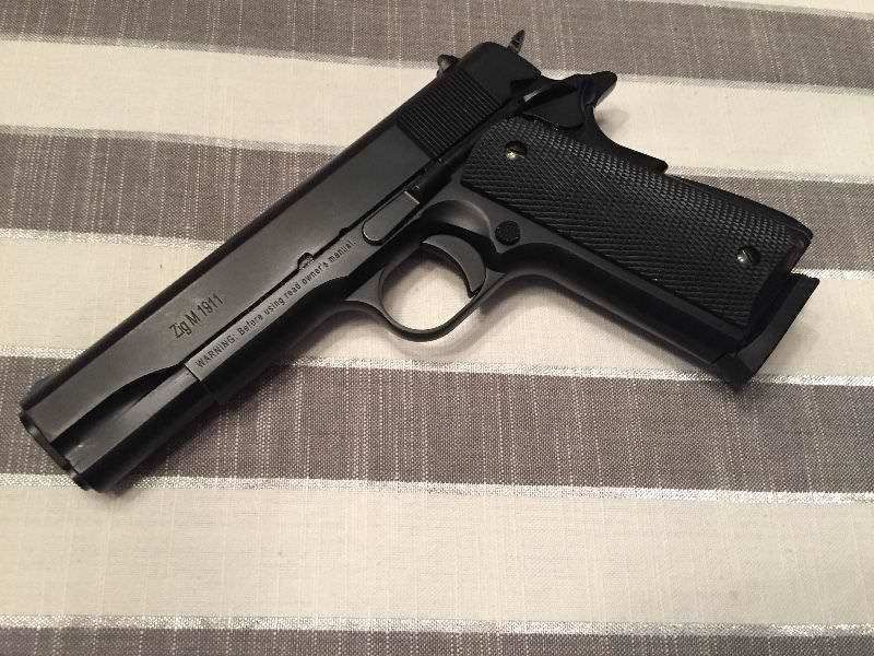

Idk, the nitride on my Sig may be nice, but I had a Turkish Tisas 1911 w/ a beautiful finish & smooth as silk.*
