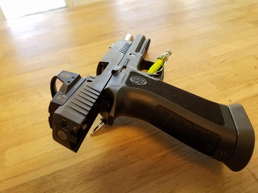

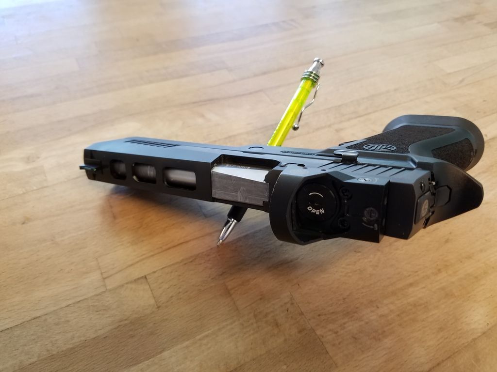

I picked up my P320 X5 yesterday, and removed the Romeo1 from my RX and put it on the X5. Then installed the GGI Pelt trigger. I was in a rush and forgot to measure the pull before, but I would say a very smooth 6lbs estimate. New pull is avg 3lbs 12oz, nice trigger.
First on the Romeo swap, the Romeo is not dovetailed into the RX slide (at least neither of mine are) as I have read several places. I was holding the slide upside down while removing the hex heads and while waiting fro the screws to drop free the romeo 1 released right with them no dove tail, not sure where that came from. After installing it on the X5 when I got to the range it was about 3 inches low at 30 feet...which was way closer than the factory install on the RX. No criticism just though it was noteworthy how close it was from one gun to another.
On the GGI trigger it did not "drop in" on the X5. The trigger drive pin area on the trigger bar had more material around the hole, which caused the GGI trigger to bind in the X5 which it did not on the RX. I filed a tiny bit of material from the trigger bar, and got it to move freely.
With the PELT trigger and spring trigger pull is now avg 3lbs 12oz with 300 rounds through.

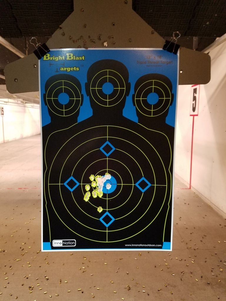

At the range, the gun was flawless. I have to confess I didn't do a thorough clean and lube. Just a quick wipe down, a swab through the barrel, and a little milcomm on contact points, and to the range. I zeroed in the Rome1, and put a total of 300 rounds through it with total perfection (at least on the guns part). While in the pistol rest, bullets were going through the previous hole...eyes aren't great and had to bring the target in a couple of times to make sure I wasn't off paper or something. It only took about 20 shots in the rest to get it right.
Free handed the gun is very comfortable. Balance is spot on and great ergos. Every gun for me is a learning experience, I have to figure best grip, position and grip strength, where to apply pressure and how firm(I know this is a fault of my abilities, and I work on it.) Thjis was also after a pretty tough workday, and breathing gasoline vapor for the last couple of hours of the day so not the best condition for shooting. but even while figuring it all out for the new gun, the shots were not "way off" only slightly. Don't get me wrong I had a few flyers, but not counting those, the gun seemed like it did what I wanted the best it could.
this was at 30 feet, not my best work, don't judge the gun by this one.

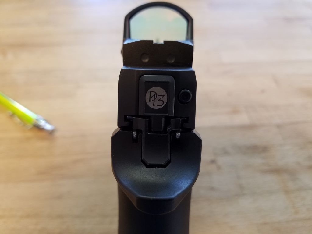

Looks like the X5 does not allow use of an iron rear sight with the Romeo1? Nice photos.
Thanks
The notch in the rear of the Romeo 1 is your rear sight for cowitnessing...works well.

Notch? I didn't know it had one. Then again, I haven't taken the ROMEO1 off of my RX.
The elevation adjustment is in the notch. It looks questionable, because it's not very deep, but it really does work. You can see it in one of the pics I posted...front blade is blurry (in the pic) but you can get the idea.
Ah, so it does! That's great! I should have picked up on that. Thanks!
