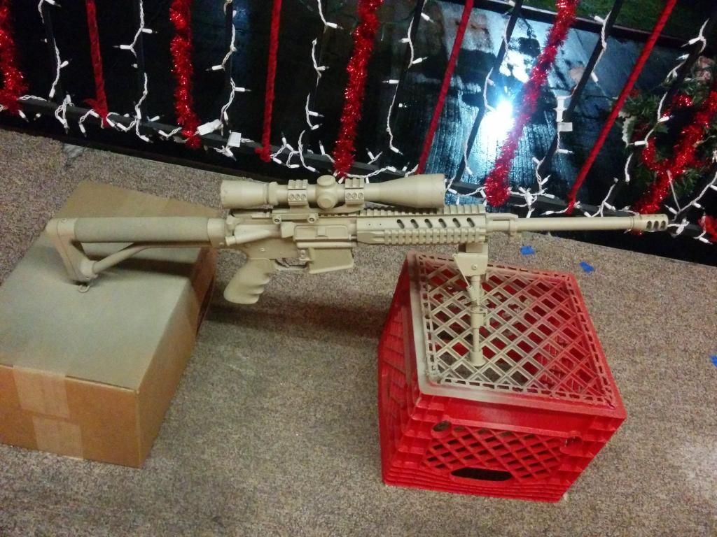

Sorry no pictures this far but here they come.
Once its primed you can start applying your colors.
I started with tan.
I then sprayed OD green stripes on top of the tan.
Once you have your stripes you will take your tan paint and spray it into a container such as a paper plate or tuperware bowl, I chose paper plate for disposability.
Then take a chunk of your sponge and spong tan blotches onto your green stripes.
Then take your green and sponge the green onto your remaining tan.
Now take some brown and sponge it over the whole rifle. Its personal preference on how much brown you want, I personally wanted just a little brown on the rifle.
Then do the same with your black, now black is not natural in nature, so you want to use this sparingly.
A tiny bit goes a long ways.
Now you can go ahead and spray your clear.
Here's the final product.

Thanks everyone, stencils for digital camo will be sweet!
I thought about going that rout but got impatient. And multicam looked difficult to make look good.
Its chilly here, about 50 degrees outside. I live in an apartment and was able to work around the cold weather.
I put my paint can in hot water in the sink for about 15 minutes before I sprayed. Also put the gun and a space heater in my tiny bathroom for about an hour to heat it up and make a little sauna. With the vent on I could take the gun outside spray it. Let it dry there for about 5 minutes then move it inside to hot bathroom. With the vent on, it took all the fumes and there was no paint smell in the rest of the apartment. I let the tan dry about 30 minutes, then let my stripes dry about 30 minutes. And then put it on my coffee table and sprayed onto the plate outside then came inside to sponge. Maybe a tiny bit of paint smell but not much. My wife was not bothered one bit so couldn't have been bad. The hot bathroom and constant air corode a big difference in dry time and I believe the hot paint and the gun being hot when I sprayed helped the finish and dry time. I clear coated the next morning because it was so late. But start to finish past night was about 2.5 hours. And then another 30 minutes in the bathroom drying this morning after clear coat.
